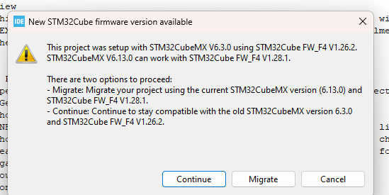

hello i downdload latest version but again this error will come when i press migrate or continue option after that iam updating my code in this code  goes to  error part. fix this problem.

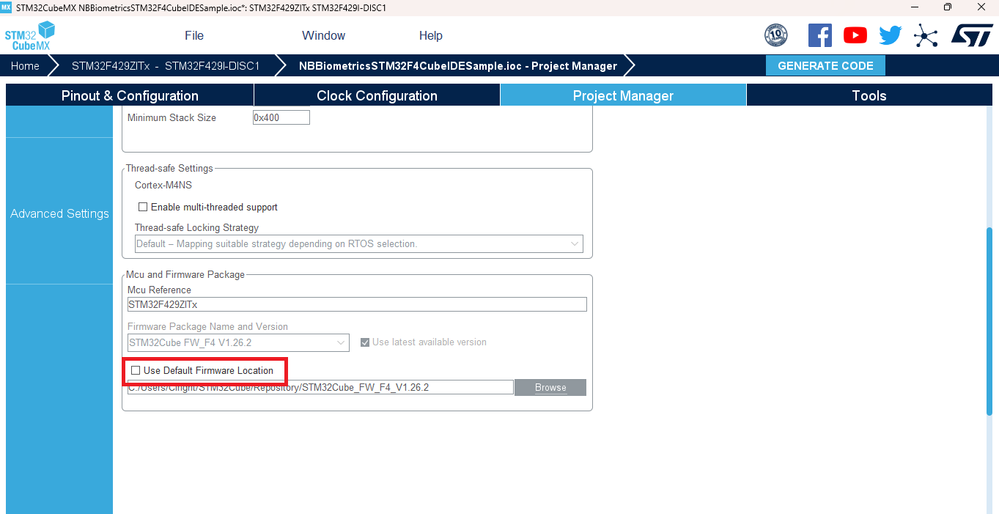

Check if V1.28.1 is available in this path: C:/Users/<user name>/STM32Cube/Repository/
I mean check that you have STM32Cube_FW_F4_V1.28.1 folder at this drive location: C:/Users/Ciright/STM32Cube/Repository/
Otherwise, check the checkbox: "Use Default Firmware Location":
You shared the same screenshot here.
I've already suggested, either:
1- to check if you have  C:/Users/Ciright/STM32Cube/Repository/STM32Cube_FW_F4_V1.28.1 path on your drive.
or, check the checkbox: "Use Default Firmware Location" and regenerate the code. Normally CubeMx will download the missing package:

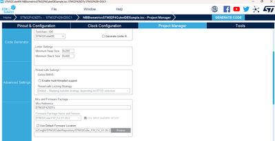

i tried this one but still after i genarate code , shows error ?how can solve this error?
yes i tried this one but still code not working
But I don't see from your shared screenshot you checked the option:  "Use Default Firmware Location":
