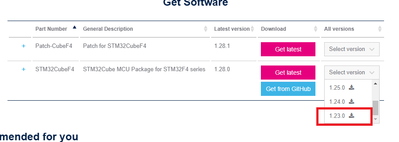

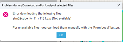

2024-12-11 8:00 AM
I think the cube package F4 V1.18.1 is no more available for download from ST website.
The oldest version available is at this date is V1.23.0.
So either you configure your project to point to the latest version of the HAL or open an ols ticket to get F4 V1.18.1.
2024-12-11 3:34 AM
can you specify the error message?

2024-12-11 8:00 AM
