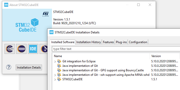

Here is what I have in Help > About > Installation Details once installed:
Then it's pretty simple to use, but way of working differs depending if you want to clone and existing repository (Import > Git > Project from Git) or start from scratch using a local repository (Team > Share).
All is already well described in eGit user guide (https://wiki.eclipse.org/EGit/User_Guide).
