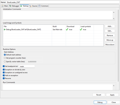

I appreciate the quick response, but I believe I tried what you described, and its NOT working. Attached is an image of my setup in the Debug configuration when working with the elf file only (debugs as expected)

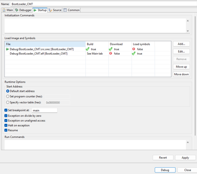

Here is an example of when debugging is not working(using SREC file along with the elf file. Ialso switched the order and it still doesn't work

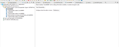

This is the screen I get after clicking "Debug"

@dsmail1 What you did (the 2nd screenshot) is the correct way and it should work. So either the srec file after manipulation is broken or debugger in your CubeIDE version is broken. Please try to break immediately after load (in the Startup tab set breakpoint on Reset_Handler instead of main) and see what code is loaded.
