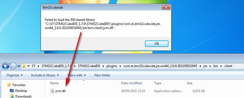

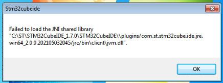

This issue is all over the internet, and as usual with no good solutions.
One of the two files which Cube says is not present actually is in that directory. I am totally stuck, having spent a day on this and downloading all sorts of VC++ redistributable fixes. I am doing this on two machines, both running a win7-64 VMWARE VM. This is Cube 1.7 although I tried 1.6.1 also (which I have running ok on the base machine, but that machine has had years of updates...

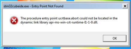

Of course google searches take one to needing C++ redist update 2015 but that generates error 0x80240017 :)

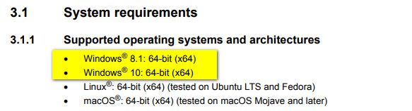

Edit: just discovered the likely cause of the problem: ST changed their system requirements post v1.4:
although for some reason the online update to 1.6.1 worked ok on two win7-64 machines. But doesn't work on a 3rd win7-64 Enterprise SP1 running in a VMWARE VM.

If you suspect that the cause of install failure is VC++ 2015 redist update, or ucrt update - maybe there's is a medicine for that.

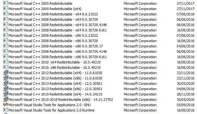

One can find the VC++ 2015 and 2017 install packages but they fail, with error messages which google to thousands of hits ...

Cube 1.4 and 1.5 install and work. 1.6 does not.
It appears to be a dependency on which version of VC++ redists you have installed. Cube seems to need at least VC++ 2015, but this is extremely difficult to "just install"; you get obscure 8 digit hex error codes which google to huge numbers of ineffective solutions. The way to get VC++, up to 2019, was via regular M$ Windows updates, but they stopped a while ago.

It does (this is from my win7-64 PC). You just can't install it from any of the install packs. It used to come on the M$ auto updates but they stopped (except for paying M$ support customers)
