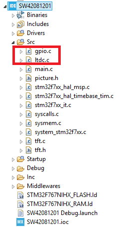

For example when I use GPIO and LTDC, the for the STM32F767 I get such a structure (looks better for me):

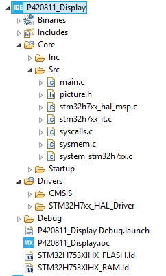

And when I generate the code for the STMH753 then I get such a structure and the initialization functions are directly in the main (not optimal for bigger projects):
My question: How to change the automatic code generator to use the same way of working like for the STM32F767 (modular code)?

2020-05-09 2:09 PM
In STM32CubeMX, go to Project Manager -> Code Generator -> Generate peripheral initialization as a pair of '.c/.h' files per peripheral

2020-05-09 2:27 PM
Thank you! That was what I was looking for :)
