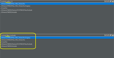

I am trying to compile a STM32 project with my own code structure. I have not changed the structure created by the IDE when creating the project and have added my .c and .h files in the Src and Inc folders in Core directory. But I am getting an error where the compiler is not able to find the include paths. I am attaching the error and screenshots for your reference. I have added the include paths in project settings. Is there something that I am missing?

@ronk123 wrote:But I am getting an error where the compiler is not able to find the include paths.
What error, exactly, are you getting?
Please copy the full build output from the 'Console' window, and post here as text.
@ronk123 wrote:I have added the include paths in project settings. Is there something that I am missing?
So do those paths cover every include file in you project?

Yes, those are all the include paths in my project. I have attached a txt file which has the console output
2024-11-19 2:35 AM
@ronk123 wrote:Yes, those are all the include paths in my project. I have attached a txt file which has the console output
Thanks - so these are the actual errors:
<command-line>: fatal error: ../Drivers/STM32F4xx_HAL_Driver/Inc/Legacy: No such file or directory compilation terminated. <command-line>: fatal error: ../Drivers/STM32F4xx_HAL_Driver/Inc/Legacy: No such file or directory compilation terminated. <command-line>: fatal error: ../Drivers/STM32F4xx_HAL_Driver/Inc/Legacy: No such file or directory compilation terminated. <command-line>: fatal error: ../Drivers/STM32F4xx_HAL_Driver/Inc/Legacy: No such file or directory compilation terminated. make: *** [Drivers/STM32F4xx_HAL_Driver/Src/subdir.mk:64: Drivers/STM32F4xx_HAL_Driver/Src/stm32f4xx_hal.o] Error 1 make: *** Waiting for unfinished jobs.... <command-line>: fatal error: ../Drivers/STM32F4xx_HAL_Driver/Inc/Legacy: No such file or directory compilation terminated. make: *** [Drivers/STM32F4xx_HAL_Driver/Src/subdir.mk:64: Drivers/STM32F4xx_HAL_Driver/Src/stm32f4xx_hal_cortex.o] Error 1 <command-line>: fatal error: ../Drivers/STM32F4xx_HAL_Driver/Inc/Legacy: No such file or directory compilation terminated. <command-line>: fatal error: ../Drivers/STM32F4xx_HAL_Driver/Inc/Legacy: No such file or directory compilation terminated. <command-line>: fatal error: ../Drivers/STM32F4xx_HAL_Driver/Inc/Legacy: No such file or directory compilation terminated.
They are, in fact, all the same error - they all refer to just one folder, ../Drivers/STM32F4xx_HAL_Driver/Inc/Legacy
Note that this is specified as a relative path.
The trouble with relative paths is that they only work when you start from the right place...

Remove everything in the lower part of the includes dialog : Include files (-include).
2024-11-21 1:36 AM - edited 2024-11-21 1:37 AM
@Pavel A. wrote:Remove everything in the lower part of the includes dialog : Include files (-include).
Ah yes - that lower section is "Include files":
@ronk123 but the entries you have specified there are not files - they are paths!
Here is the documentation of what -include (ie, that part of the dialog) does:
https://gcc.gnu.org/onlinedocs/cpp/Invocation.html#:~:text=Process%20file%20as,chain%20as%20normal
And this is what -I (the Include Paths section) does:
