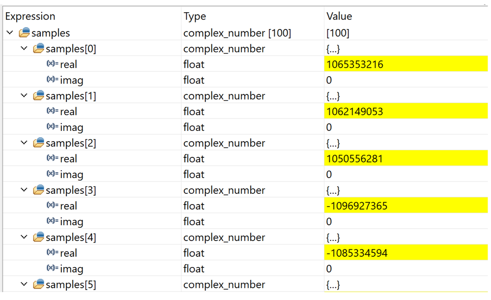

As a learning exercise I'm trying to generate 100Hz cosine wave & then eventually do a DFT on it but I'm getting some odd results from the cos function using code below...

When I check the values in samples in the debugger....
I was expecting a value of 1 for the first entry and then subsequent values in the interval [-1, 1]
Is this a formatting issue in Cube's debugger or am I missing something obvious here?

It's a formatting error. 1065353216 is 0x3F800000 which is =1 (single-precision). The debugger should figure this out but sometimes it doesn't.
Right-click on the number and choose "Number Format".

Thanks that must be it as the rest of the code is working as expected.
Unfortunately the debugger doesn't give me that option when I right click the number, only the option to remove the variable.
2025-08-29 2:44 AM
The debugger "knows" the variables are of type float as the screenshot proves, but nonetheless fails to display the value properly.
An issue with the CubeIDE debugger, obviously.
That's odd, I don't think I've encountered that, and I (have to) do this fairly often.
Are you sure your cursor was over the value (display)? You can only set "Number Format" on a particular element, not a structure nor even an array of scalars. (You can group-select elements in an array of scalars with shift-click.)

No matter what I try I dont get the option.
2025-09-01 3:33 AM
Perhaps the debugger has a problem with struct members.
Could you try with a "freestanding" float variable ?
