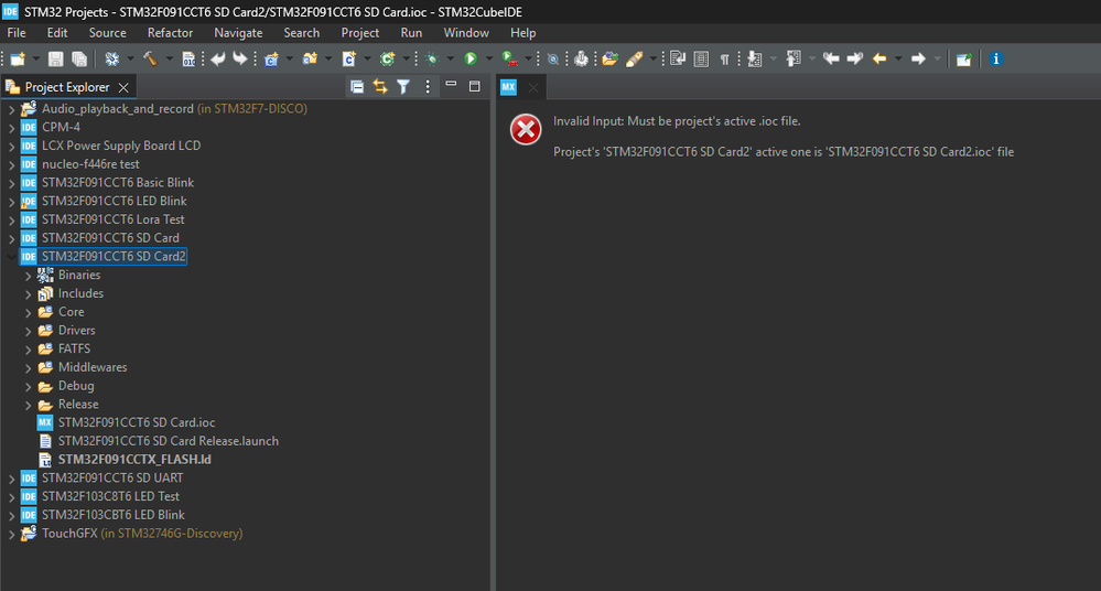

When I copy a project within the IDE, it doesn't update the file references and the IOC file doesn't open. Can we have this fixed asap please?

As a workaround, you can just rename the .ioc file to have the same name as the project.

It seems to work for now after renaming the IOC,  recompiling and setting up a new run configuration.

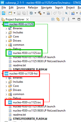

The issue is still present in v2.1.1.
For example, here I have just copied the project "nucleo-f030-cc1126" (green)
to "nucleo-f030-cc1126-hsi" (red).
The nucleo-f030-cc1126.ioc file in the new project has not been renamed to match the new project name:
Of course, in v2.1.1, this is no longer an issue as such - now that the IDE no longer handles .ioc files.
But it is still an inconvenience if one wants to keep the .ioc filename matching the project name.
