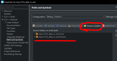

Path to ../TinyUSB/src is included:
Is there something obvious that I have forgotten? Any help will be greatly appreciated.

Probably this is a linker error, which means tusb.c isn't being compiled. There should be a gcc statement that compiles it, just like there is one for main.c. Ensure the path to it is include in Project Properties -> C/C++ General -> Paths and Symbols.

Thanks a lot. You are right, of course – the compiler doesn't complain about the #include. I didn't consider that.
Indeed, paths were missing from the "Source Location" list. Adding some paths helped. Now some errors are gone, and others have come up. Not going to spam you with those, and I'm going to stew a bit on those myself.
