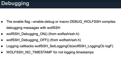

2025-04-30 2:10 AM
Just adding on here, https://youtu.be/HCT_0mA8Sss?si=KTtSoIz6VaNrM4vC&t=1402 there is a presenation on how to build wolfSSH. It is mentioned that by defining WOLFSSH_NO_TIMESTAMP, the _gettimeofday error can be bypassed.
