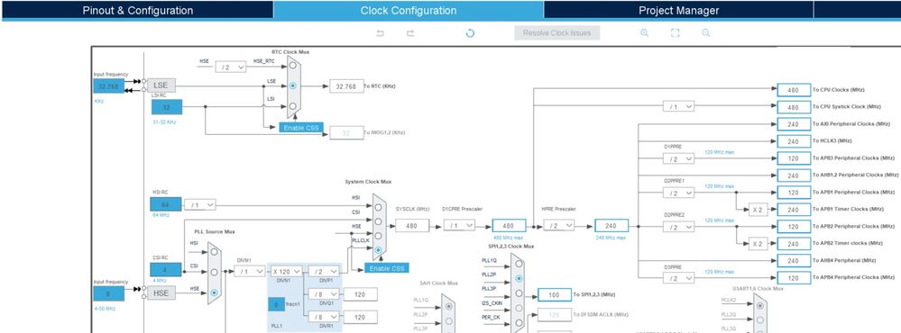

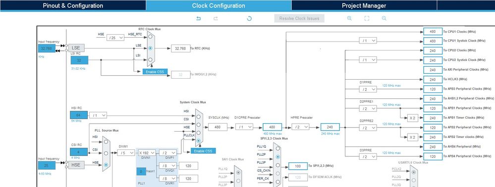

Hi Tesla DeLorean, here are two snips from the clock config.
This is the H743:
And the H745:
The main difference I can see is the HSE crystal being different between these two boards which requires adjusting the PLLs differently to achieve the same clock speeds. I did attempt using the CSI and HSI input to the PLLs and found it to be unstable when setting the sysclk up to 480.
