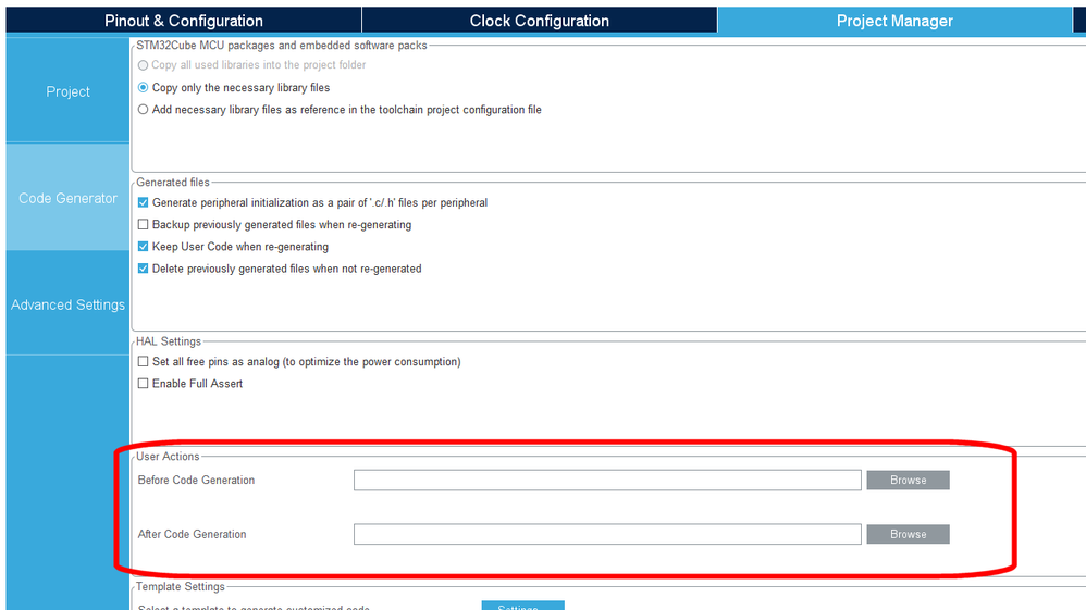

You could automate it as a User Action?

2024-09-25 12:40 AM
Maybe, I don't know. I never used this box before, because its disabled. Nevertheless I would love to try it.

2024-09-25 3:57 AM
@DN19 wrote:I never used this box before, because its disabled. Nevertheless I would love to try it.
Apparently it's only disabled within CubeIDE - it should be available if you use the standalone CubeMX:
2024-09-25 4:28 AM
It is disabled when creating code for STM32CubeIDE even in the standalone STM32CubeMX.
2024-09-25 4:37 AM
Oh well - I guess that must've changed since 2021, then?
Why is it still there if it's never enabled?!
