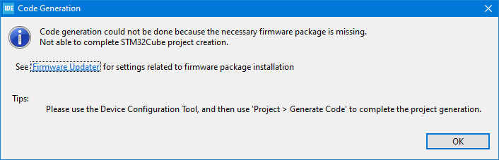

Get error message "Code generation could not be done because the necessary firmware package is missing. Not able to complete STM32Cube project creation."

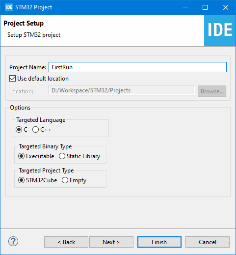

When Creating STM32Cube Project and then giving Finish will result the following

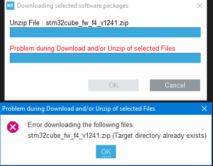

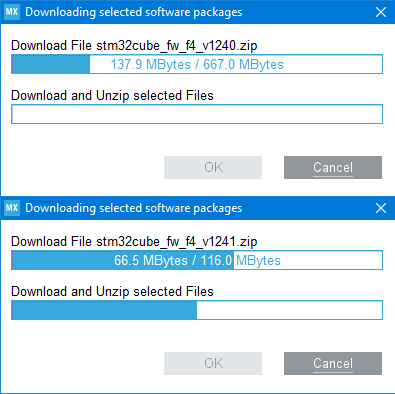

Also when downloading and unpacking software packages I get error when unpacking stm32cube_fw_f4_v1241.zip

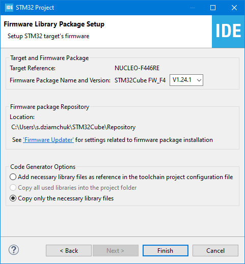

If I select V1.24.0 package I get the same error (Problem during Unzip stm32cube_fw_f4_v1241.zip)

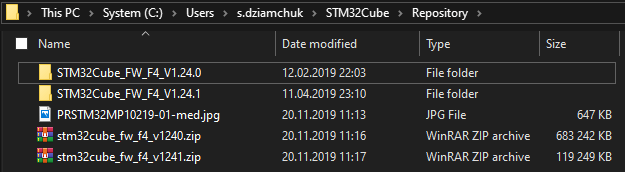

When I manually unzip v1.24.0 and v1.24.1 to different folders (like screen below) I still get Code Generation error.

@Reactor, unzipping within 2 various folders is not process IDE is intending to do. Please have a try to unzip within same directory.
F4_V1.24.0 is main FW pack delivery ... F4 V1.24.1 is only kind on patch to be applied on main delivery. If you have a look to .zip file size (or extracted material) you will confirm F4 V1.24.1 is missing some material ....

Well... The real problem is IDE can't replace files during unzip.
