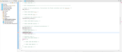

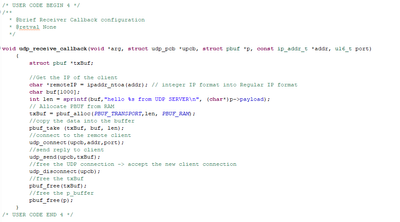

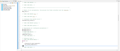

2024-05-02 9:07 PM - edited 2024-05-02 9:09 PM
Hi peter,
once again thank you for your quick reply, the below screenshot shows my example code before change in .ioc file.
The second screenshot shows my example code after changes in the .ioc file.
1. As you mentioned the code not within the "USER CODE BEGIN" deleted without further enquiry. That was done in function "udpServer_Init();".
2. But in the portion of
/* Infinite loop */
/* USER CODE BEGIN WHILE */
my own written code was also deleted. this was written under the "USER CODE BEGIN" portion.
let correct me, where I had done the mistake. It happens every time. I suffer a lot from this.
thank you.
regards
Ramachandran.S

2024-05-03 3:07 AM
Hi peter,
Thank you for your quick reply. I aware this mistake after sending this error message to you. After knowing this mistake, I tried my own "USER CODE BEGIN and END", it works fine.
In the above screenshot, the sub-program and "USER CODE BEGIN" & "USER CODE END" written me, this also work fine. Thank you for great guide.
