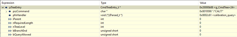

}This is the memory address of pTreeEntry that is being placed in RAM but the address of pszCommand is not in RAM.

I have been using the debugger but without any success. I do not understand why it is pointing to ROM and not RAM, because the g_CmdTree has the pszCommand initialized in RAM but when pTreeEntry is set to the address of g_CmdTree[0] it is only seeing the ROM address.
