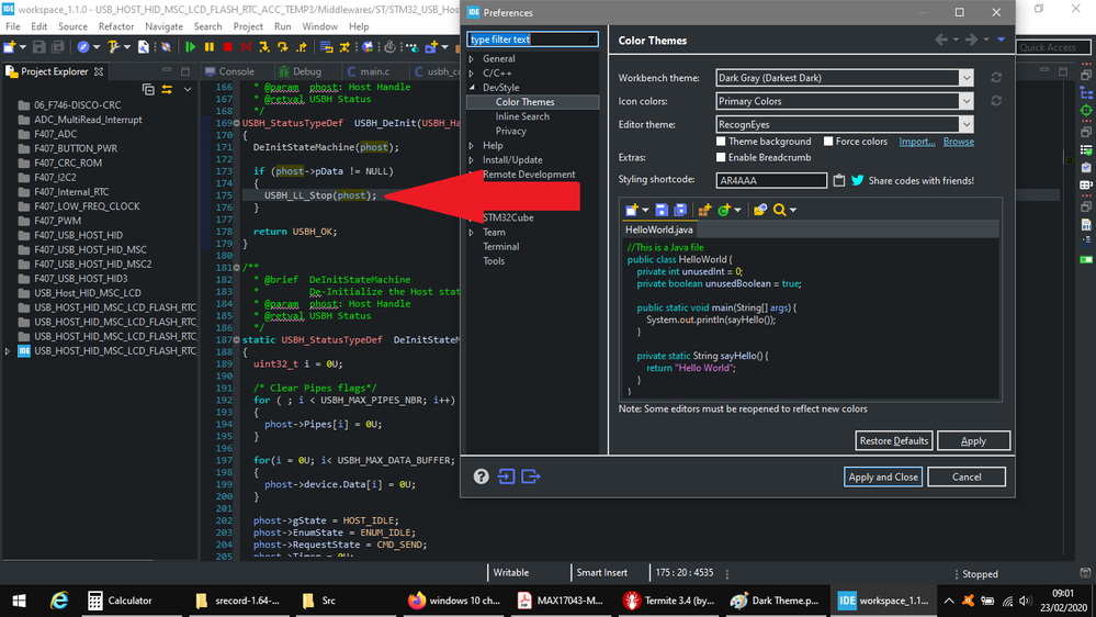

2020-02-23 5:53 AM
I tried Eclipse and even the latest version (2019-12) has this same problem.
But I managed to customize the color.
Just install an additional theme.
In the 'Help' menu, go to 'Eclipse Marketplace...'
Search for: 'Darkest Dark Theme with DevStyle'

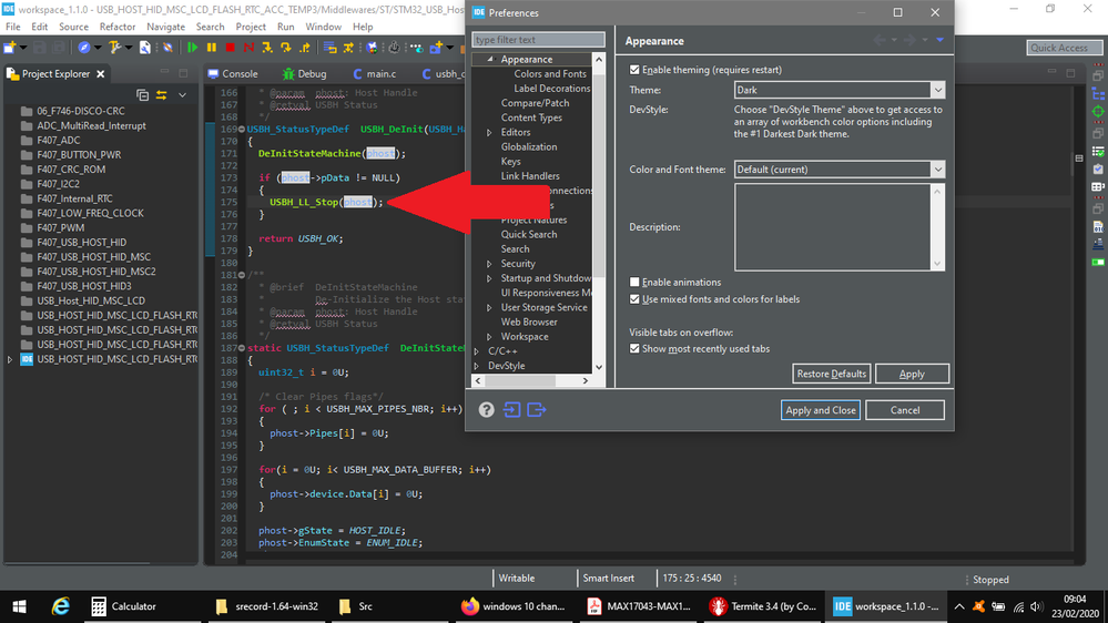

STM32CubeIDE default dark theme:
Custom Theme:
Ref.:
https://www.genuitec.com/tech/darkest-dark/
https://marketplace.eclipse.org/marketplace-client-intro?mpc_install=27025

2020-02-24 5:57 PM
Nice find. Did you have to do something to get the scroll bars dark? Mine are the original gray but yours looks fine
2020-02-24 8:59 PM
Hi, What IDE version are you using? This IDE from the image in the post above is version 1.2.0, (I'm downloading the new IDE 666 MB, version 1.3.0, for testing), I couldn't find this defect in the scroll bar. I don't know if there is any influence, but Windows is also dark in theme. Could you post a screenshot, please?
