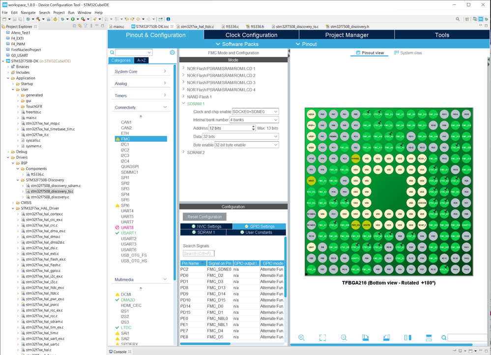

I am working on a project what started with a ST32F7508-DK, and I generated the code and project in TouchGFX. Everything was working fine. Then we decided to go from 16bit SDRAM to 32bit SDRAM. So we created a board that was a copy on the discovery kit, the only difference was that we added the pins needed for migrating to the 32 bit, which resulted in needing to move some of the pinouts for the ltdc (screen). Now after that change, I am having issues flashing and running identical programs on the board (identical meaning the main code and touchgfx code did not change). When trying to flash in STM32Programmer, I am getting the message:

Also, when looking at the memory visualizer, it seems like nothing is flashing to anythgin past 0x90000000. I was wondering if I messed up something in the SDRAM configuration, am i missing something in the bootloader/linker file, etc. This issue is also repeatable with the same hex file on a different machine and a different board.

Ok, so it turns out that although the QSIP chip has changed, we never implemented it. We were planning on using it once the project got larger, but for now we are only using the SDRAM and the normal MCU flash memory. Also, it seems that after some clarification, the SDRAM also has not changed. The only difference is that before we wired it up for 16 bits (just like the discovery kit), and now we wired it up for the full 32bit.
So I guess the question would be, if I took a discovery kit, and kept everything the same except for wiring it up for 32bit as opposed to 16 bit, what would I have to change?
