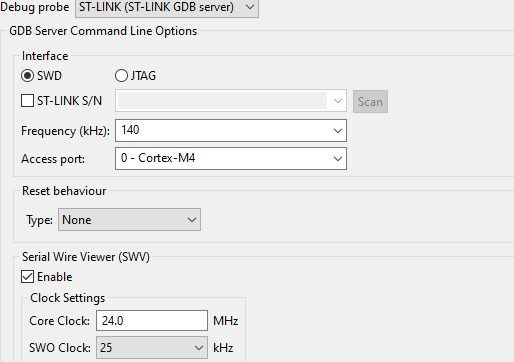

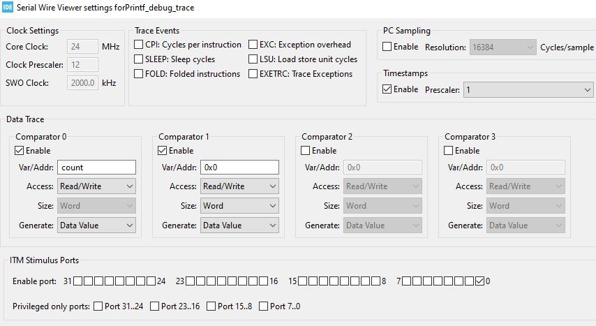

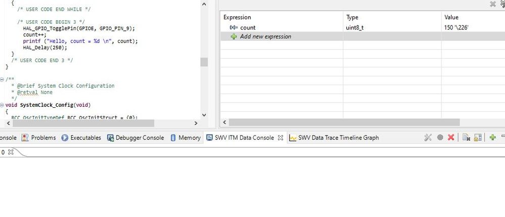

I am trying to Debug with SWO and SWV in STM32CubeIDE. But i am not getting any thing on SWV ITM Data console and Timline Graph. As you can see in live expression window count is incrementing as expected. My clock is running on 24Mhz.

Is your CoreClock indeed 24 MHz? This is not the oscillator frequency,
The value must be equal to global var SystemCoreClock after return from SystemClock_Config() in main(), in MHz.
For example if SystemCoreClock is 64000000 specify 64.0
Also you must click on the ITM console start button, not earlier than when the debugger stops on the first breakpoint (usually at main). Otherwise it won't start.

Clock are same and I first clicked the console start button before hitting resume for debugging.
