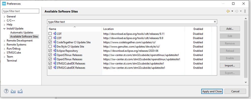

Hi @Julien D_OEHAUDT, unfortunately this does not help. Same error.
UPDATE: Looks like I solved the problem now. I replaced an update site pointing to something like http://sw-center.st.com/stm32cubeide/updatesite1/1.4.1 with http://sw-center.st.com/stm32cubeide/updatesite1/1.6.1 then it updated ok and this site with the version disappeared. Please check my update sites in the screenshot do they look ok now? Thanks in advance.

2021-04-12 12:01 AM
Yes the sites urls look good like this.
Having the version suffixed means that you want to lock the update on a specific product version.
1.6.1 didn't disappeared, not sure how you verified this but all sw-center.st.com sites are not browsable from any browser, this not means that the repositories are not there.

To clarify once again: Before I could update it seems that the updater was locked to 1.4.1 for some reason, although I had 1.6.0 already installed. At least 1.4.1 was at the end of one of the URLs, ask ST why!
So I replaced this 1.4.1 with 1.6.1 and the update worked. After the update there was no more number appended as you see in my screenshot above.

@Julien D_OEHAUDT I mean 1.6.1 is not appended to any url in the screenshot as it was the case with 1.4.1. I did not take a screenshot unfortunately.
