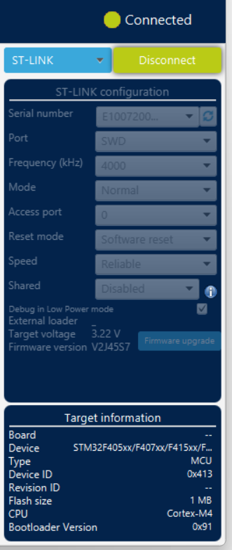

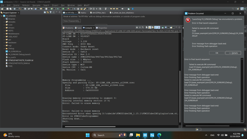

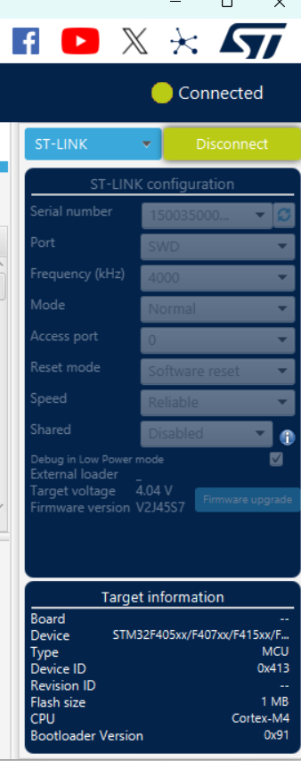

hi, thanks for last week's question, sorry for not replying you earlier, but the good thing is that I solved my problem completely, basically I got another stlink to use and it has no problem anymore.
but I wonder why the old stlink with target voltage of 3.23v can debug or use normally with stm32f103c8t6 chip but cannot debug for stm32f407vgt (must use another stlink with target voltage between 3.57,-4.5v to debug and use normally)?
