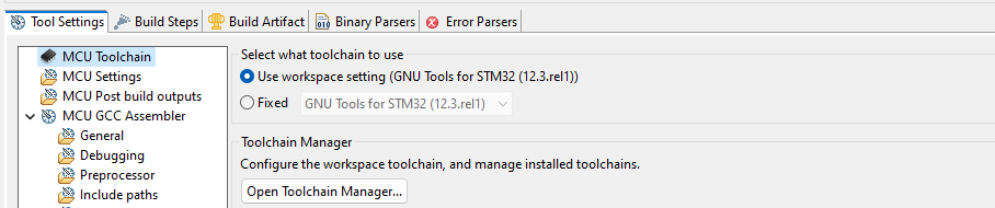

Can you post a screenshot of the toolchain selection in your project?

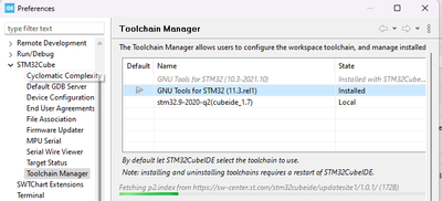

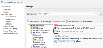

Hello @aelgammal
Could you try to make the build using the "GNU Tools for STM32(11.3.rev1) toolchain.
KR,
Semer.
