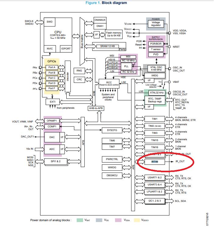

Not supported? In the STM32U031 data sheet the IRTIM peripheral is mentioned. See the attached screen-shot.

Hello @aerauliqa
I checked RM0503 and found no mention of IRTIM. Currently, I will verify this because there is a discrepancy between the datasheet and the RM.
THX
Souhaib
2024-10-10 7:23 AM
Hello @aerauliqa
After double-checking, yes, the STM32U0 supports the IRTIM peripheral. I confirm that there is an issue with CubeMX that will be resolved as soon as possible.
