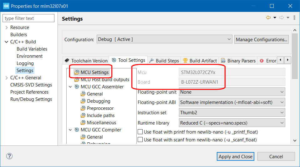

In a genuine, "native" STM32CubeIDE Project:

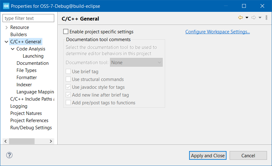

In the imported Eclipse project, that stuff is nowhere to be seen:
there isn't even anywhere to enter it manually

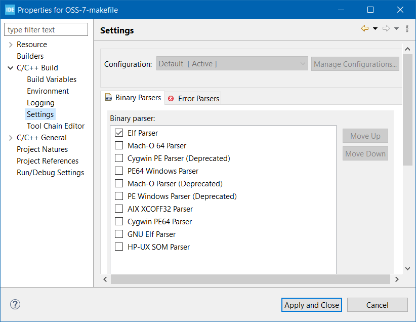

in the imported makefile project, the C/C++ Build > Settings section does exist - but there are no MCU settings:
and, again, nowhere to enter it manually
