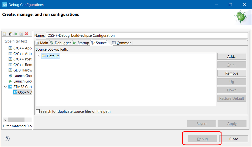

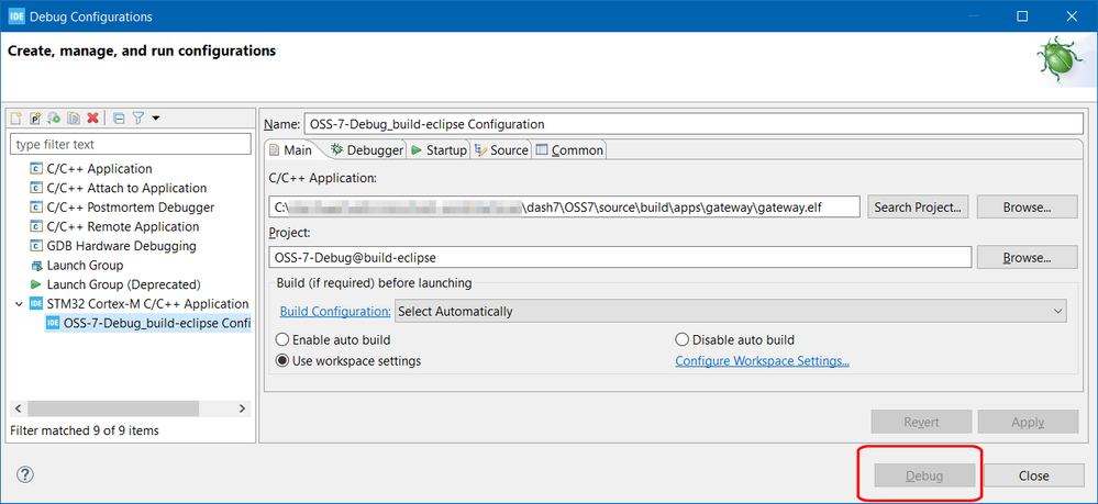

Specifying -G "Eclipse CDT4 - MinGW Makefiles" on the CMake command line completes without complaining, and does create the expected Eclipse .project and .cproject files.
STM32 Cube IDE happily opens these, and builds successfully.

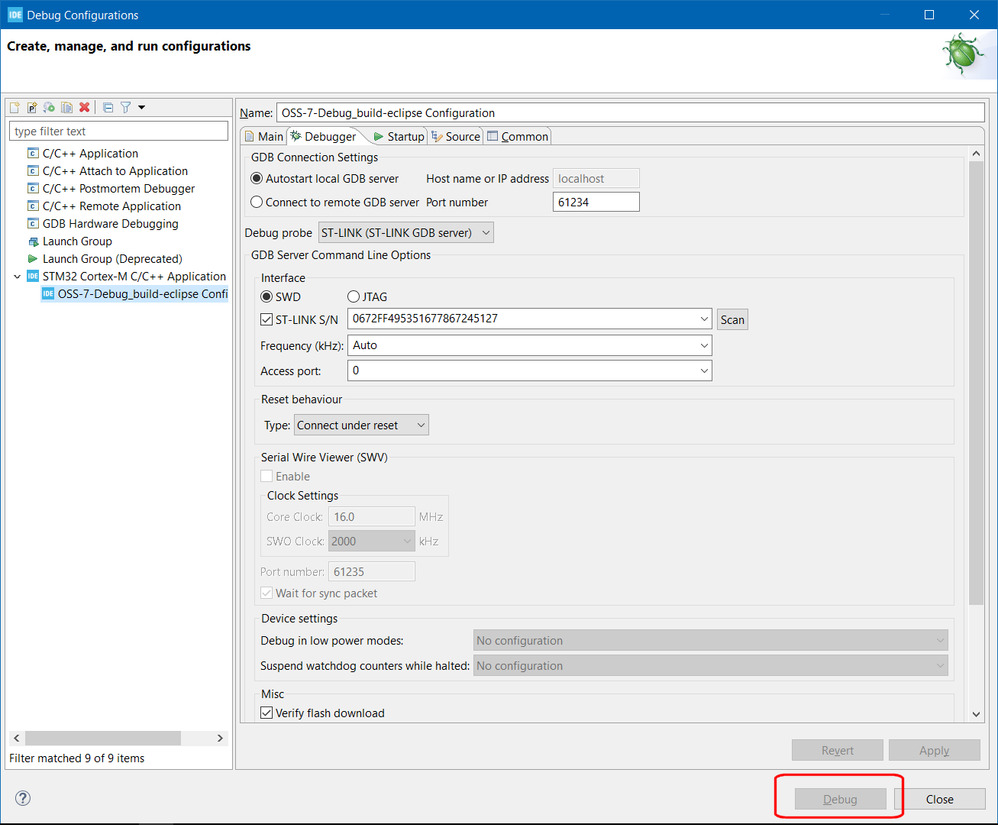

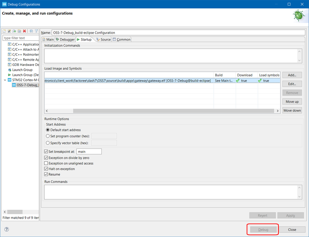

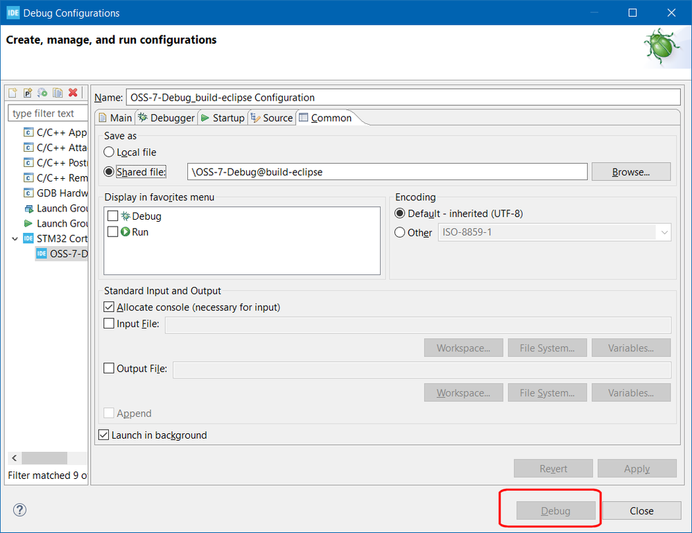

But I can't seem to create a Debug configuration that works - the 'Debug' button always remains greyed-out - even after pressing 'Apply' on any changes:
So what's going wrong?
Why can't I use this Debug Configuration?
What is keeping the 'Debug' button disabled?
The Target is a B-L072Z-LRWAN1, it is connected and a 'Scan' on the 'Debug' tab will read its serial number.

Most probably STM32CubeIDE required metadata lacks here. Possibly share .project & .cproject files

Maybe because CubeIDE does not know how to debug x86 binaries?
MinGW is not a Cortex-M toolchain.
Have you tried to generate a makefile and import it into CubeIDE as a makefile project?

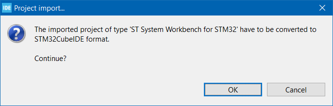

2021-02-08 4:23 AM
Interstingly enough, when I open a .project file for SW4STM32 (as found in many ST examples), the CubeIDE recognises that a conversion is needed:
but there was no such warning in this case.

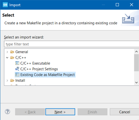

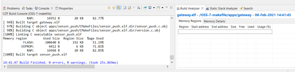

2021-02-08 7:22 AM
Trying importing 'Existing Code as Makefile Project’:
The import completes without complaint, and builds without errors or warnings:

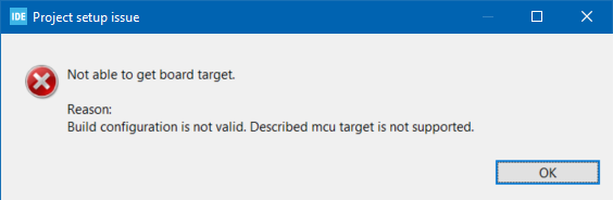

I create a Debug Config, and fill-in the details on the 'Main' tab - but 'Apply' or trying to go to any other tab gives:
I don't see where to specify the MCU target in any of the Debug Config tabs - maybe it's elsewhere ... ?

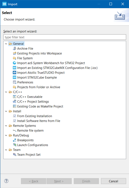

2021-02-08 8:08 AM
"STM32CubeIDE is for sure able to import vanilla Eclipse project"
So how would you do that?
I don't see anything obvious in the 'Import' options:
Which is the 'Import Vanilla Eclipse Project and Add CubeIDE Metadata' option?
