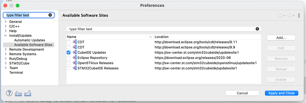

2020-11-03 8:55 AM
Reload Available Software Sites successful.
First attempt at Check For Updates failed with a SHA256 error. I closed all projects, changed the updatesite1 address to https:// and added "/" on the end and ran again. It worked with those changes.

2021-09-03 9:51 AM
Thank you! I have finally managed to update CubeIDE too using your suggestion.
I added a new Software Sites option starting with https:// then unticked all the others and it worked just fine. Should I re-tick any of the other options?
