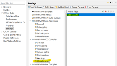

Starting from CubeIDE 2.1.0 version, you could use C23 by following these steps:
1- right click on the project > Properties > C/C++ Build > Settings > MCU/MPU GCC Compiler > Miscellaneous > Add a new flag "-std=gnu23"

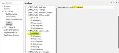

2- click on "C/C++ Build > Settings > MCU/MPU GCC Compiler > General > select "GCC Default" in the "language standard" combo list 
3- Apply and close the Settings dialog
4- Clean and build the project
