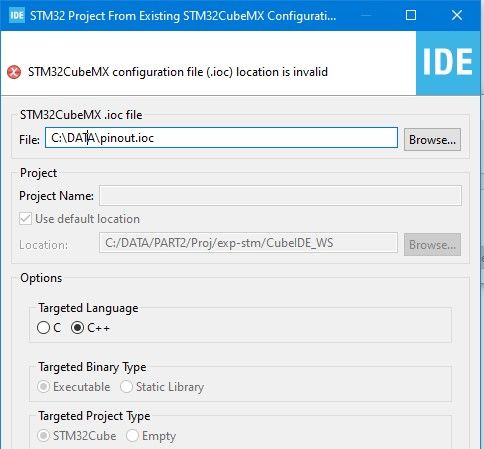

This is very simple in the latest CubeIDE. Just create a new project: New-> STM32 project; then select "C++" here:
0693W000007CkulQAC.jpgNote that you don't want to touch the Cube-generated main.c and other c files at all.
Just add all your C++ code in your own file with cpp suffix and call it from main.c. Of course, don't forget extern "C".
