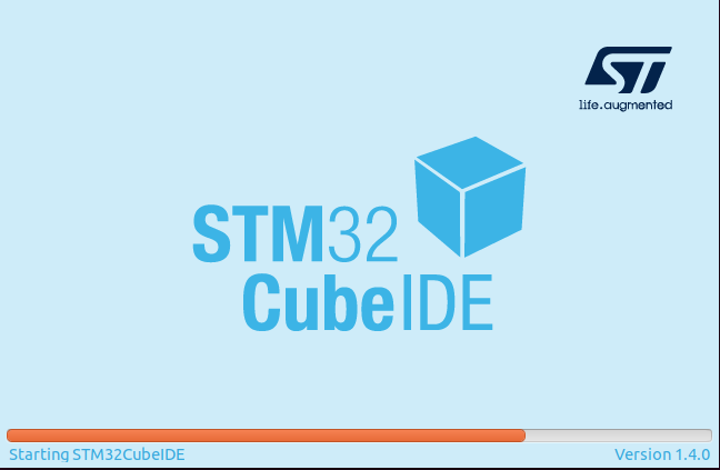

After installing update 1.4.1 the splash field showing 1.4.0 has not changed.
It continues even after opening and closing several times.

Because just after the update if you still only use the restart button the splash field is not updated:

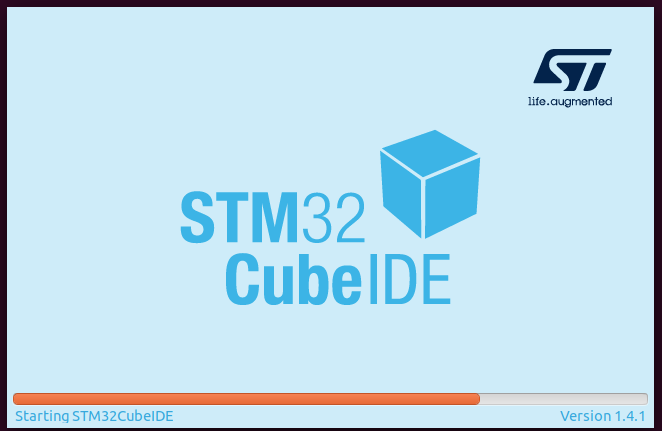

But then as soon as you close the CubeIDE through red cross or File -> Exit menu the splash field is updated:

But now it was possible to install the update and the splash window is showing 1.4.2.
