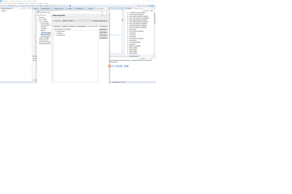

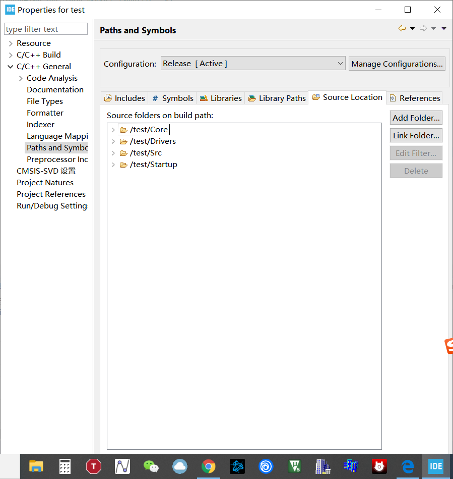

2019-06-08 11:48 PM
Hello, I found a solution to this bug.
The reason for this error is after “clean�?, the directory of the project source file is incomplete, and the file path under "/test/core " is missing.After manually adding the path "/test/core", the problem is solved.

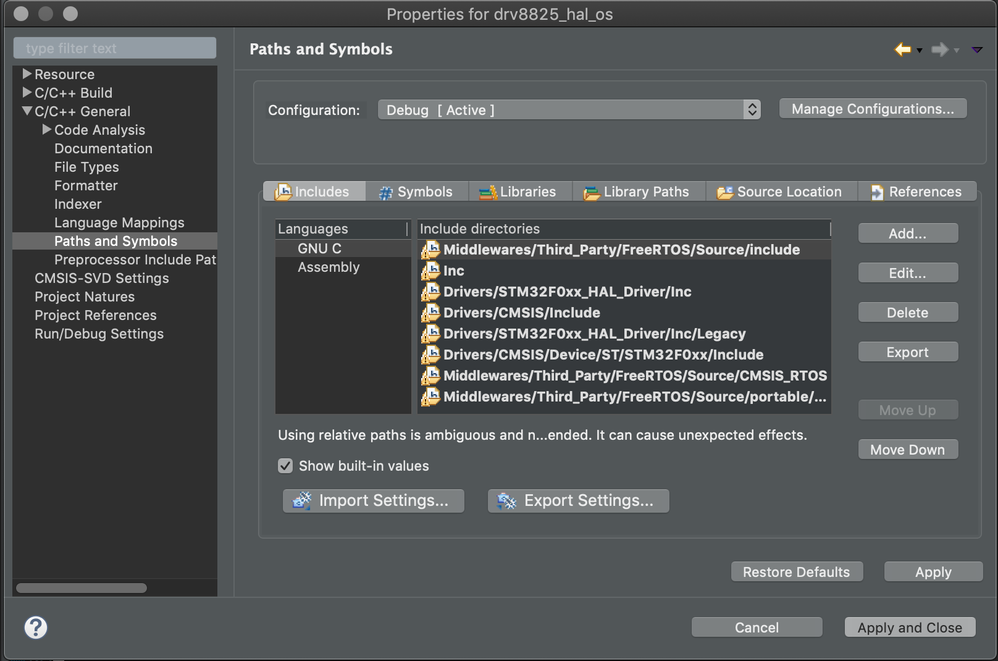

An unknown symptom of the IDE is that Paths and Symbols -> Includes settings are initialized.
This problem occurs when cleaning up the project or restarting the IDE.
The solution is to create the project first, export the configuration from Paths and Symbols -> Includes, and put it in the root of the project directory.
