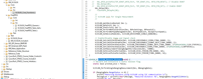

Weird things are happening.
The breakpoint i set in the void Read_ToF_From_VL53L0X_FreeRTOS_Task(void *pvParameters) task is not getting hit
this task calls VL53L0X_Measure_Distance function in which i set a breakpoint which is working ok !
also i put another breakpoint in the file VL53L0X_FreeRTOS_Queues.c which is called upon initialization
this is also not getting hit
is it a problem with teh specific folder?
but the VL53L0X_Core_Functions.c also on the same main dir
does the FreeRTOS dir have any problems?
Has anyone experienced this problem?

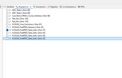

What device? The number of hardware breakpoints is limited. If you try to set too many, you should get a message about it.
Consider clearing all breakpoints, verifying that none are set in the Breakpoints tab, then setting the one you want to see if it will work.
2025-10-09 6:22 AM - edited 2025-10-09 6:29 AM
STM32H750VBT6
i also tried to set only the breakpoints in the task Read_ToF_From_VL53L0X_FreeRTOS_Task still not working
