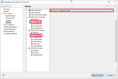

I was also problem using breakpoints, but after checking Project settings it is working.
I am using Nx_UDP_Echo_Client Application example, and Breakpoints work here.
You can check if you have setup correct Debug levelel in Project Settings for C++ and Assembler
And verify if you did not have enabled Skip All Breakpoints in Run menu
I hope that this will help you.
