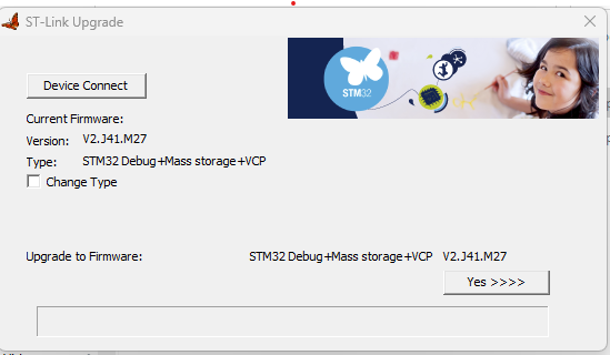

Here is the current firmware version:

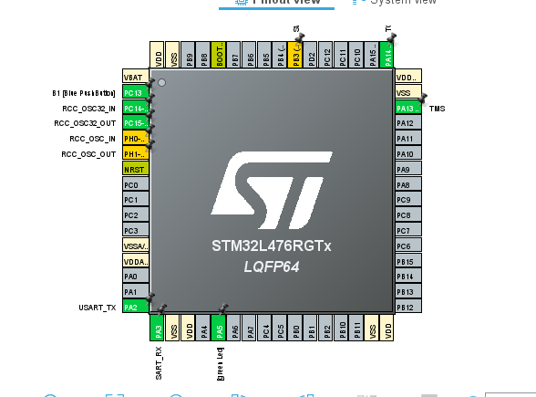

Pinout is here:

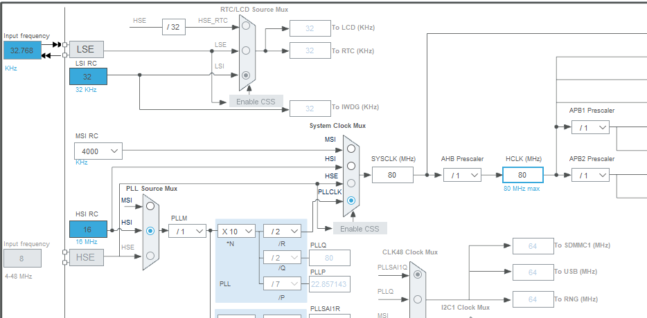

Clock configuration:
