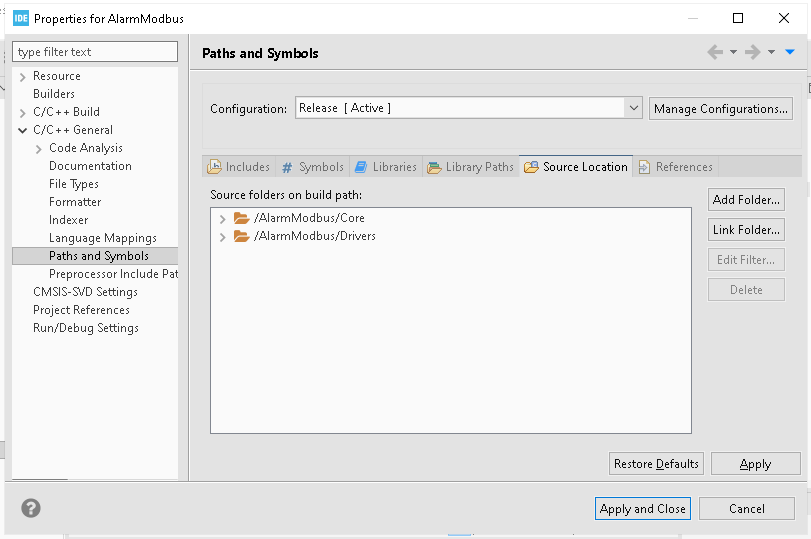

2020-11-16 7:38 AM
if output compiler error duplicate function Check On source.mk it any list double file
goto project properties
delete any list folder , this work for me
