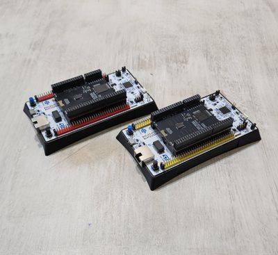

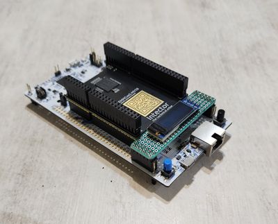

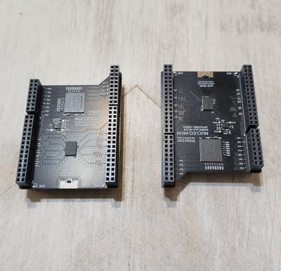

I found a solution to the problems with the AZRTOS Web Server and FTP Server. The main issue was the memory. I found a better memory assignment for all the tasks and got it working. As for the SD card, I made myself a board with an eMMC chip that gave me 8 GByte of storage.
It's the Kingston EMMC08G-MV28-01J10. It works very well on the NUCLEO-H753ZI board. The web server grabs files from the filesystem on the eMMC chip.
I just finished my upgraded "NUCLEO-MEM" board.
This board has the Kingston EMMC08G-MV28-01J10, an APS6408L-OBM-BA 8 MByte PSRAM, and an LXMS21ACMD-220 which is an UHF-RFID Impinj Monza4QT chip. I'm in the middle of testing it and hope it'll run OK.
The annoying issue with the STM32CubeMX code generation is that overwriting code still exists, but I mainly use VisualGDB from SysProgs for development, which is much better than STM32CubeIDE.
