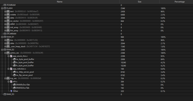

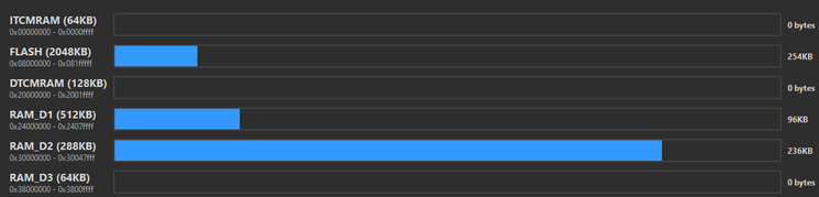

2024-05-01 1:05 PM
I actually did this to be able to check the memory usage, but it's not very useful. I'm using Microsoft Visual Studio with VisualGDB for the development, and this gives me a tool which is called "Embedded Memory Explorer". It shows a very detailed memory usage for all variables and threads.
Here is the general memory usage overview:
and this is a detailed view of the memory usage:
This tool is very good and helped me a lot in detecting memory issues.
2024-05-01 2:37 PM
Very similar to STM32CubeIDE Build Analyzer. Only problem is that it is static.
Or is that a profile after running using TraceX?

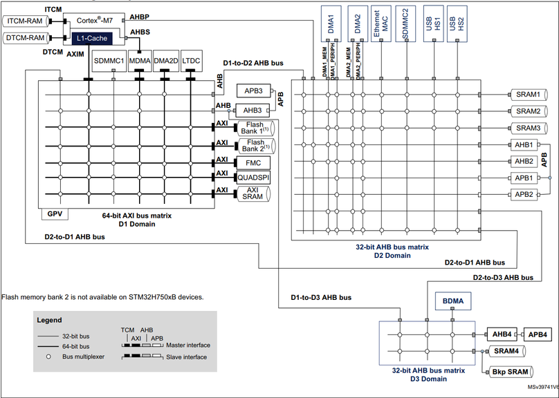

I finally found the problem and got everything working. The problem is that I connected the SD-Card to SDMMC1 which is in the D1 Domain. I had the AZRTOS system as static allocation and placed it in the address range of the D2 Domain. The SD driver cannot access anything in the D1 Domain under these conditions.
To solve the problem, I simply moved everything belonging to the AZRTOS to the D1 Domain.

Also, I placed a public repo on GitHub which a complete functional example for the STM32H7 with AZRTOS, HTTP-Server with content from SD-Card, and FTP-Server to update the SD-Card content. I tested FileZilla in passive mode with binary file transfer which works great.
GitHub repo for STM32H7-AZRTOS example
The memory has to be optimized because I used it very generous.
