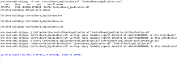

i am trying to make an offset for my application to have a start of flash for bootloader. So i set up an offset in linker file, so instead of 0x08000000 to 0x0804B000 and vector table offset during startup. But the problem is that i am unable to load the application into flash (as you can see in picture). When i add post build command i can see an interresting error (second picture) showing that there is an empty loadable segment in address that is nowhere mentioned in my code. This address is always the one, which was used previously and i cannot get over it. I have tried to clean project and remove whole "Debug" folder but the same error again. Also i have marked option "Discard unused sections" in build settings.

Information about empty loadable segment:

More probably an issue with the linker script failing to impart what you actually want to happen vs what you tell it to do..
Here is it complains about 0x20000000 likely due to where you're staging initialization data.

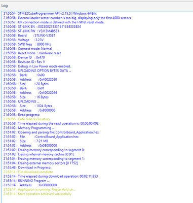

}How could linker symbol address lead to fail during flashing? I have problem with flashing itself not a running the app. This is output from STM32CubeProgrammer with standard base addr:

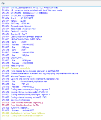

And this with offset:
BTW, the address is changing, sometimes it is previous address with empty loadable segment, but usually is this one:
The end block in message "erasing internal memory" is incorrect. So CubeIde is generating something incorrect.
