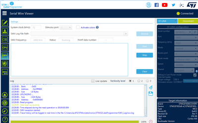

2024-08-01 1:31 AM
You can use CubeProgrammer and connect to SWV :
+ just set real cpu frequ.
2024-08-01 1:36 AM - edited 2024-08-02 9:06 AM
ST-LINK Utilities used to do it and STM32 Cube Programmer can do so now.
Code running on MCU can set up ITM, DWT and FPB too depending on how hard core bare metal you want to go.

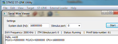

2024-08-01 12:42 PM
Yes this is great. I have the ST Link Utility and that picks up the data
Curiously it reboots the target when it starts up but that's OK.
Thank you all!

2024-08-02 9:08 AM
Not sure if ST-LINK Utilities offer connectivity options, ie so you can hot-plug
STM32 Cube Programmer might have more, and less disruptive, connection modes.
There should be a SWV tab/pane on the newer versions
