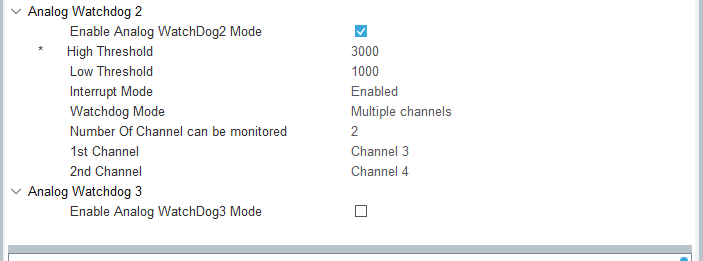

My analog watchdog settings:

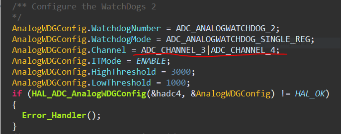

After generating code, ADC file shows:

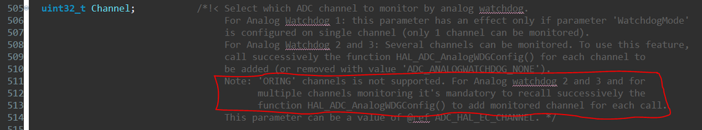

When I was investigating, found this comment in stm32u5xx_hal_adc.h file, ADC_AnalogWDGConfTypeDef structure definition:
After applying what is mentioned in the comment, watchdog works on both channels.

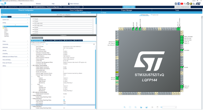

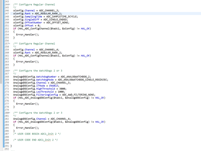

After using CubeMX 6.12.0 and try to reproduce the issue mentioned above , this is what I got after generating the code :
I am sharing with you my IOC

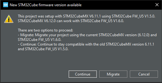

2024-07-10 12:26 AM
It is shown here:
