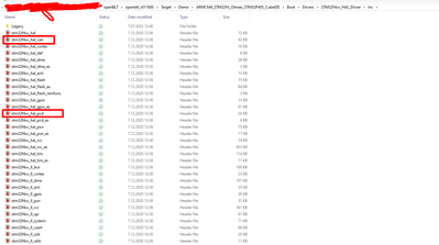

Many files are deleted such as below. What could be the reason behind and how can I avoid it ?
2024-02-05 11:56 AM
Files from 2020, so very old project, most likely using different CubeMX verson and HAL library version.

2024-02-06 12:55 PM
The project generates code and builds successfully for me without errors.
The stm32f4xx_hal_can file is deleted as the project does not have any CAN peripherals enabled. Similar story for the PCD file.
