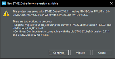

I have a project on Nucleo board with STM32U575ZIT6Q. I'm using STM32CubeIDE.
My ADC worked fine until i did this:
After migration HAL_ADC_Start function returns error.
When I generate code I use this setting:
