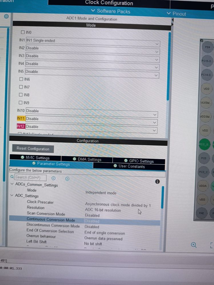

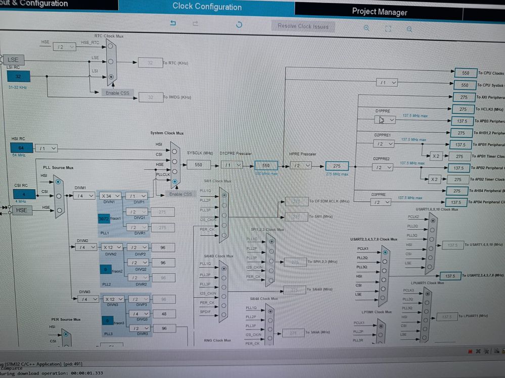

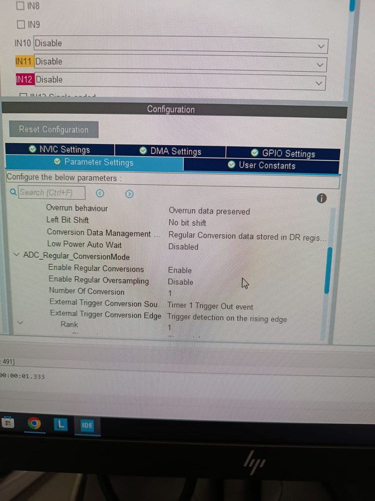

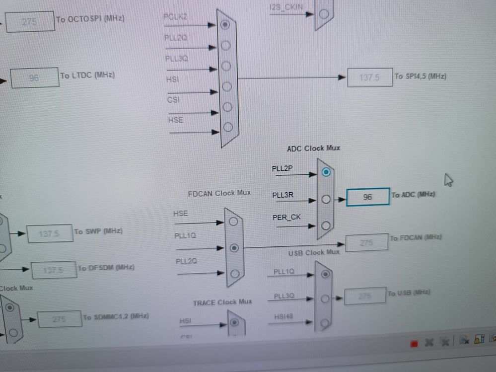

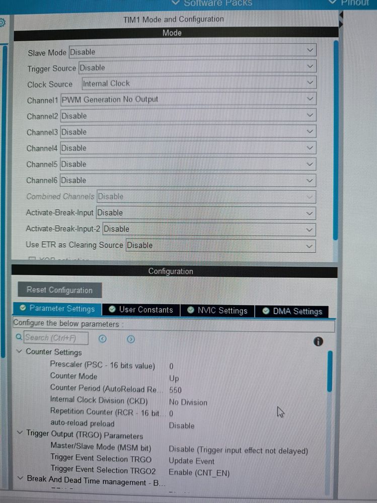

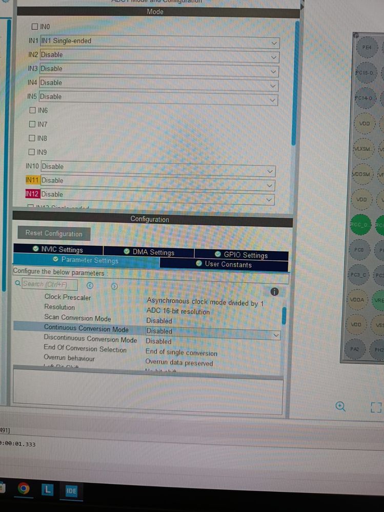

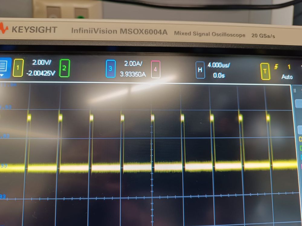

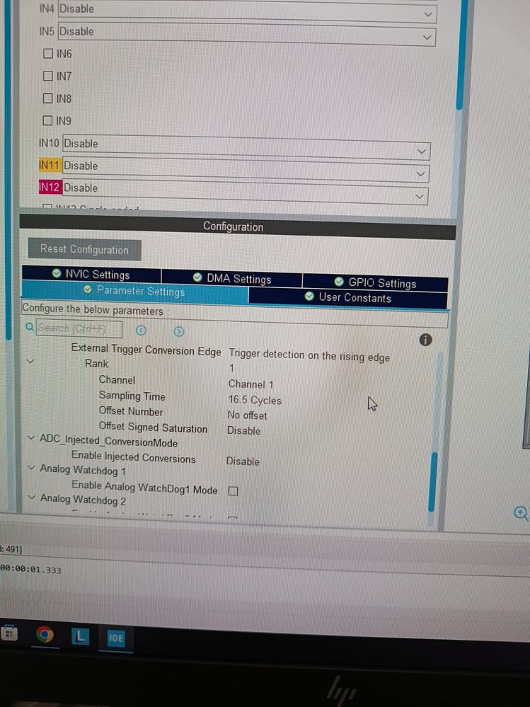

I’m working STM32H735G-DK, I tried to synchronize the ADC with timmer1, I want to synchronize it at 500 kHz but the maximum that I get is 250 kHz. This are the images for clock configuration, ADC1 and Tim1, a GPIO is set in 1 when get into on the HAL_ADC_conCpltCallback function is the yellow waveform.

Using a DMA based solution is the better option at this high of an interrupt frequency.
