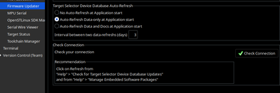

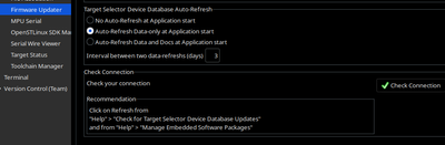

Hi AScha.3,
As you can see from the first attached screenshot, I eventually found the
"check connection" button buried in Preferences/STM32Cube/Firmware Updater and
clicked it. This caused the display of the formerly missing green tick. Please
see the first attached screenshot.
I then implemented both Recommendations shown in that section. Implementing the
first recommendation did cause files to be downloaded and unzipped.
Implementing the second recommendation also caused files to be downloaded and
unzipped, in this case taking only a couple of seconds.
BTW, whilst I was in Window/Preferences/STM32Cube/Firmware Updater, I clicked
the Network Connections link in the Connection Setup section. This caused the
display of the Network Connections preferences as shown in the second attached
screenshot. Should I make any changes here ?
The result of this activity is that the Information Center tab still(!) remains
blank.
Is there something else I need to check/do ?
Stuart

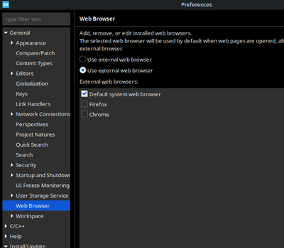

so ide check : green - should be ok.
Only thing, i would try: the browser setting (because info page is a web based page)
- i have chrome in use and set here also to use it as default

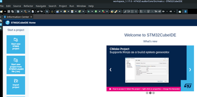

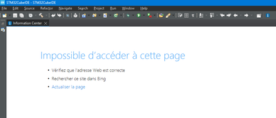

2025-08-04 11:37 AM
I have the same problem with Version: 1.19.0. I tried to reinstall, but still the same problem.
