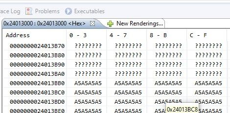

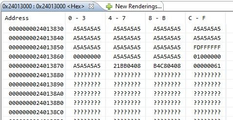

I'm debugging a program on STM32H753 in Atollic TS 9.3 and see something weird.
It looks like unreadable hole in D1 RAM from 0x24013880 to 0x24013BAF
Is this artifact of the Atollic's debugger, or???

2020-07-02 11:51 PM
Can the firmware running on the MCU access it?
Is it reproducible after you power cycle everything?
2020-07-03 12:12 PM
Doesn't reproduce after restarting everything. Looks like bug of the debugger...
