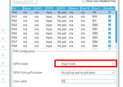

Hi everyone I'm rather new with programming with STM32 controllers and I am currently using NUCLEO-L432KC. Currently I'm facing a problem with HAL_GPIO_WritePin() function. I am interfacing with a 16x2 LCD and I am trying to write to the RS pin via the function I have mentioned, however I am facing a problem where the RS isn't being set to the desired value I am providing. I have provided the value like so: HAL_GPIO_WritePin(RS_GPIO_Port, RS_Pin, rs);
Where I have given rs = 0 but the function is setting the value as 1. I have also provided the photo of the RS pin configuration from the IOC file.

Hi
from your ioc file
PA0.GPIOParameters=GPIO_Label
PA0.GPIO_Label=RS
PA0.Locked=true
PA0.Signal=GPIO_InputYou see the Error? "GPIO_Input"?
