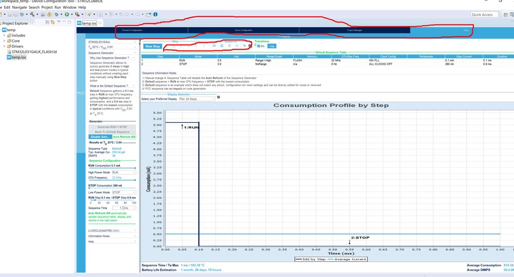

2020-04-03 12:15 PM
Hi Aymen,
Thanks for this tipp!! Found it under
Window > PREFERENCES > STM32Cube > Device Configuration Tool > Font size.
This indeed helps for most of the text, but especially the text in the registertabs and the icons are not are not (yet) influenced by that (see attached screenshot). But it's definitely possible to work like this, thanks!
One recommendation: Wouldn't it be an easy thing to switch this automatically after installing the CubeIDE, so all people with 4K screens don't have to struggle over this? Pretty sure many out there still had the same problem and couldn't find this settings...
Thanks again, this solved the problem for me.
