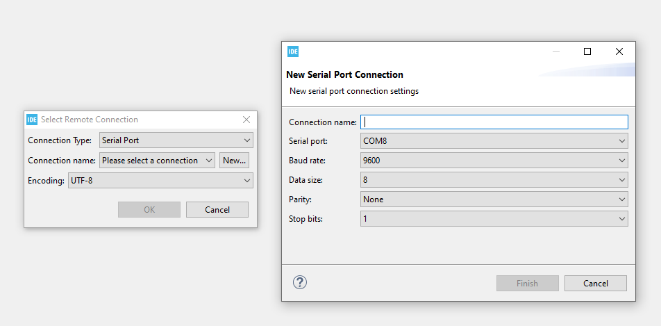

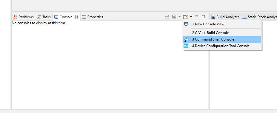

Check the signal with an Oscilloscope.
Create a new Command Shell Console.
Configure the new Console just as you did with PuTTY.

Regarding PWM watching console, does not have any inbuilt console in stm32 cube ide?
