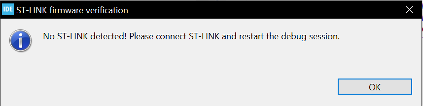

I've been debugging a custom designed board that has an FT4232 USB IC on it with a JTAG interface. STM32Cube IDE up to 1.3.1 could successfully debug this through openocd. Version 1.4.0 wants to force firmware verification so I can no longer program and debug my board. How can I disable the ST-Link firmware check?

Tried that. Doesn't work for me. Still says:
Back to 1.3.0 (can't seem to find 1.3.1 for download anywhere).

Possibly reboot or kill any existing STLink server process on your host prior installing 1.4.0 from installer.
Fact is STLinker server is a running as a deamon process. If an old version is running new installation may not happen as expected.
