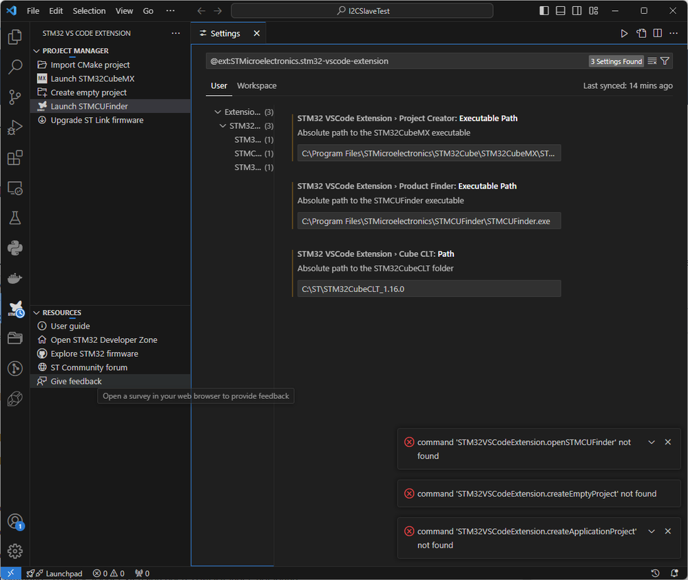

No matter what I click on in the VS Code add-in, I get errors like the ones below.
How do I solve it?
command 'STM32VSCodeExtension.importProject' not found
command 'STM32VSCodeExtension.createApplicationProject' not found
command 'STM32VSCodeExtension.createEmptyProject' not found
command 'STM32VSCodeExtension.openSTMCUFinder' not found

I am having the *exact* same issue. This is my first time trying to use STM32 tools with VSCode. So far this plugin has not done anything useful. I really hope to see good results like others have.
VSCode extension Version 2.1.0
CLT Version 1.16
CubeMx Version 6.12.0
MCUFinder 6.0.0

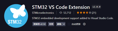

The version of STM32VSCodeExtension is too new and has bugs, try rolling back the version of the STM32VSCodeExtensionto v2.0.0
