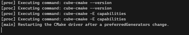

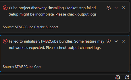

2025-12-11 5:01 PM - edited 2025-12-11 5:05 PM
Dear, what are you trying to prove to me? Something that doesn't exist. Here are the screenshots.
Tomorrow I'll try to do the same on Debian 12. Something tells me that everything will work there. It doesn't work on Windows 11.
If I understood the logic of the extension correctly, it simply can't find the local repository.
